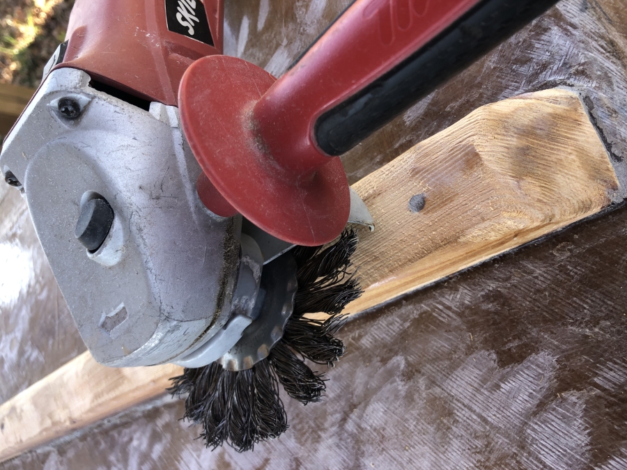

Basically, didn’t have much luck with any of the chemicals. Ended up using a grinder with a wire wheel, then wiping down with laquer thinner and following with 50 grit paper.
Also seemed to help that it was really cold. The bad epoxy firmed up a lot when it was cold, so made it a point of doing it early on a morning when it was right at freezing.
It did gouge into the wood and a few small places that had been glasses previously, but in general didn’t cause as much collateral damage as I thought it might.

Say ‘hello’ to my little friend.
