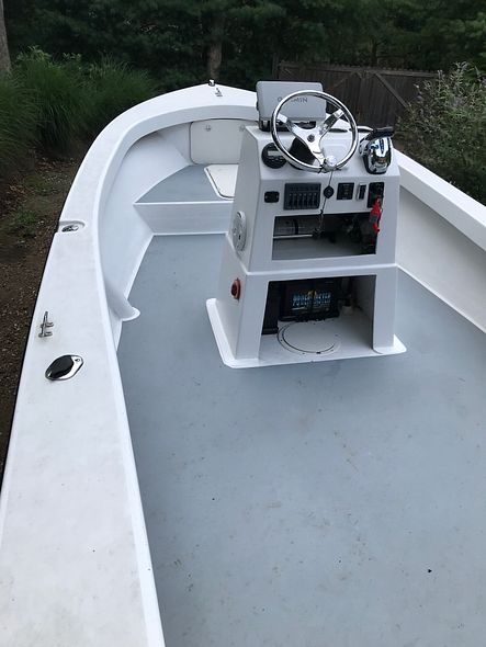

I did add 3 more photos to show the current state of the project I hope you’re seeing them on your end. If not please let me know and I’ll try and upload them again. Thanks

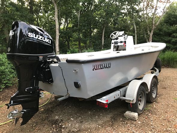

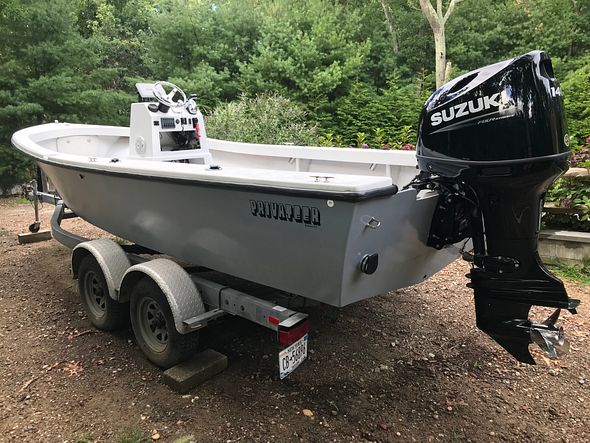

It’s been a while since I posted here last but I was able to finish the boat in the spring of 2021 and was happy with the results. Unfortunately plans have changed and the boat no longer fits the needs of my family of 4 so I will be actively looking to sell it this spring. Here’s a few shots of how the boat turned out.

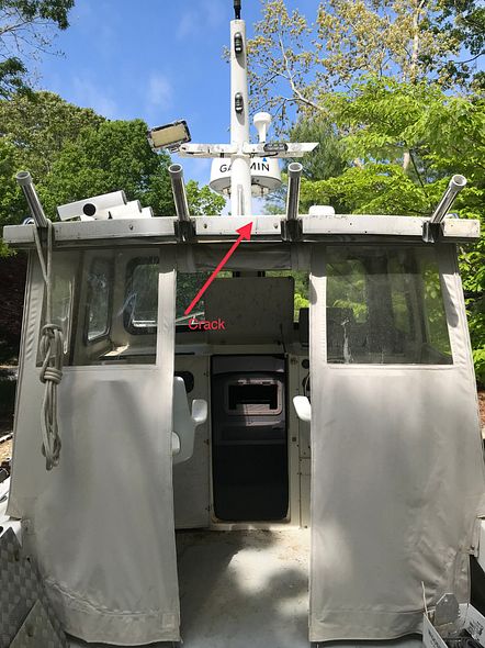

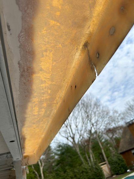

I had the opportunity to buy a 24’ Privateer in the spring of ‘22 which needs some cosmetic work but for the most part is solid. I cruised it “as is” last summer but will be doing some work to it prior to this season to get it ready. One of the ares of concern is the roof. It has many old mounting holes which have been covered up over the years as well as a decent crack on the rear lip. I plan on filling all the old holes with thickened epoxy once any rotten core is removed before placing a layer of 17oz glass over the repaired areas. My main question is how to address the crack. I thought about ripping down a piece of 3/4 marine plywood to match the inside width of the roof “lip”which would be set in thickened epoxy before running a layer or two of 17 oz or 1708 mat over the new plywood which would wrap around from underneath the roof to the top edge of the roof itself.
Is it necessary to set plywood underneath to stiffen everything up or will glassing over the crack with several layers of glass be sufficient? Here are some pictures which show the crack and the area I sanded the gel coat away to prepare for the repair.

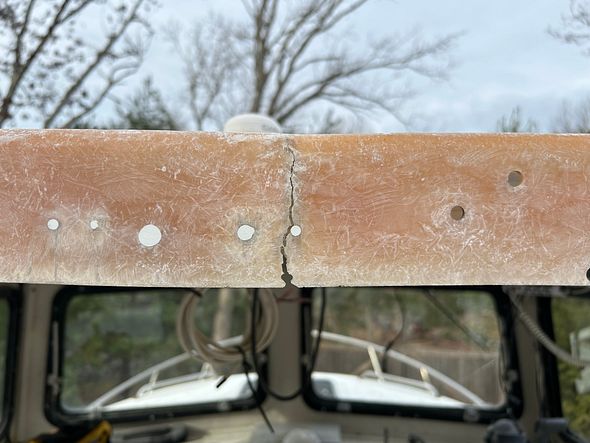

The photos I have of the 24’ Privateer I posted before are pretty poor and I will work on getting some clearer shots to show what I’m trying to achieve. In the mean time, here are a couple of photos which show the overall rear roof “lip”crack before the area was prepped for prepare as well as the entire top of the roof with the many holes that need to be properly repaired.
