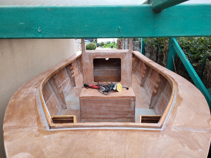

Post by OlivierP »
Hi all
After a month of interruption due to a motorbike "tour de France" with friends, I'm back at work.
I have completed the inwales, rounded all corners and filleted the edges.
10071
10073
I have also finished building the front benches and lockers.
10072
Actually there is no more part to build and install, except closing the rear decks which are already cut and dry fitted, so the construction itself is essentially finished. Feels good ! Now it's time for fairing, installing hardware, painting, then transferring the motor from the donor boat (my RIB). Hope to finish before winter as planned.

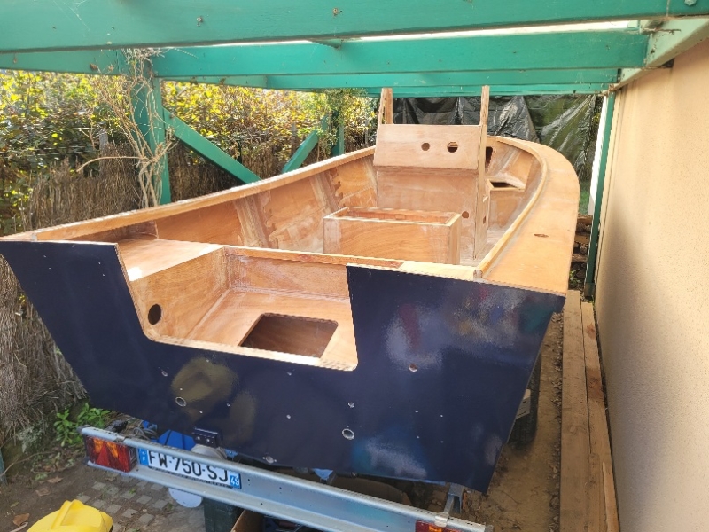

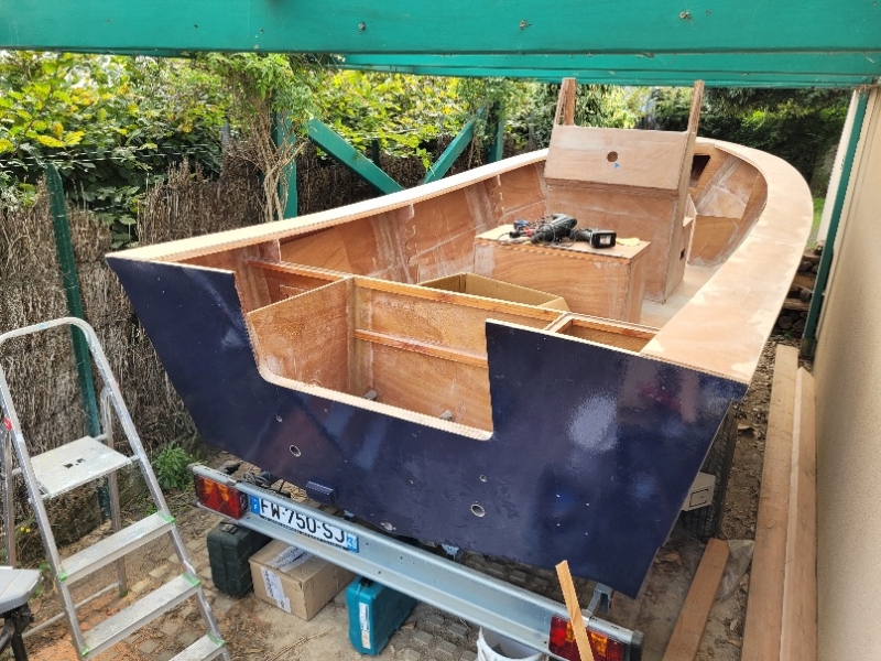

Post by OlivierP »
That's it, I have finished preparing the hull for painting, and I started priming the deck today (no pictures of the paint yet).
I have installed the rear decks, built a battery support in the aft port locker, a support and evacuation for the bilge pump, drilled holes for the controls in the console and the motor well, and drilled-filled-drilled hundreds of holes for the deck hardware. I thought it would be good enough and time to paint before winter comes.
