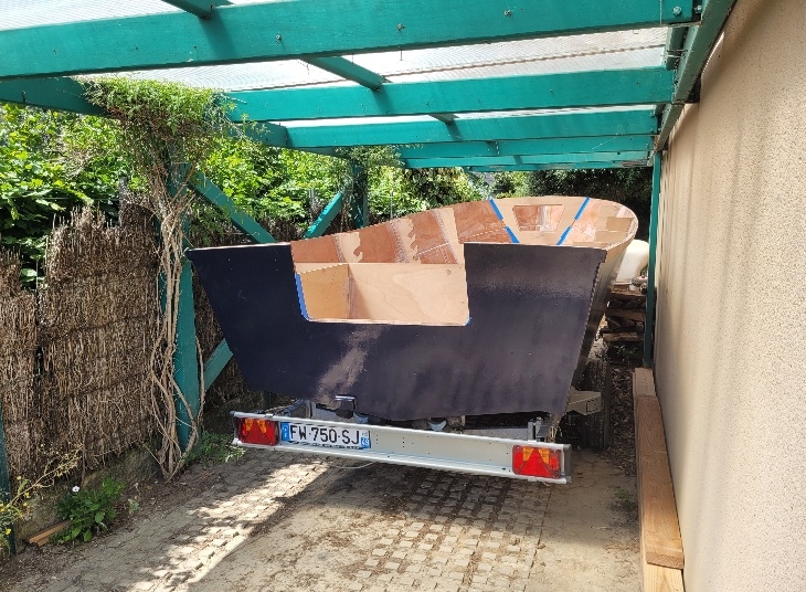

New home by the sea - as I suspected, I need to lower the wind screen by about 1'' to fit under the car port. 2 bolts that stick below the roof at the entrance of the car port... No big deal.

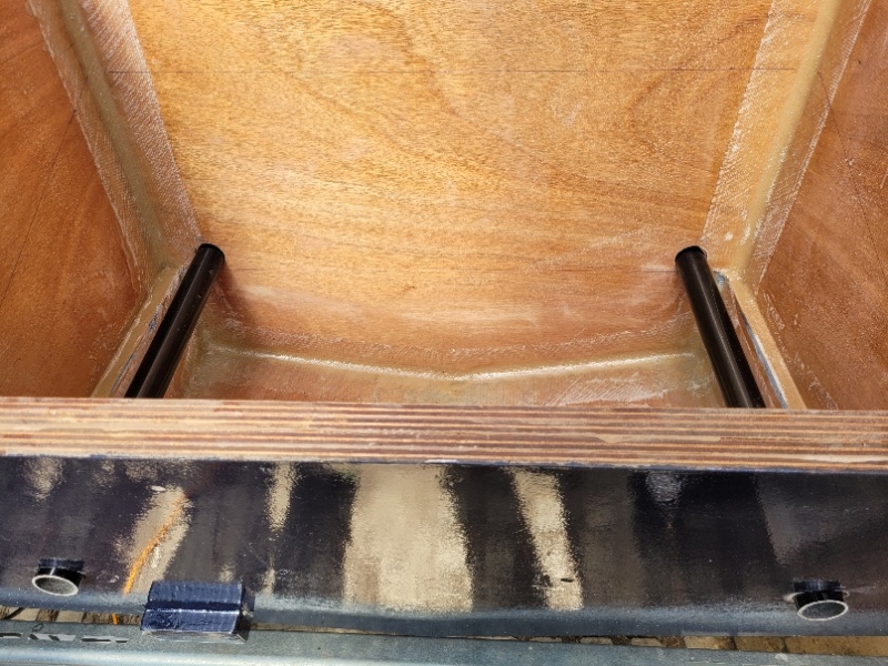

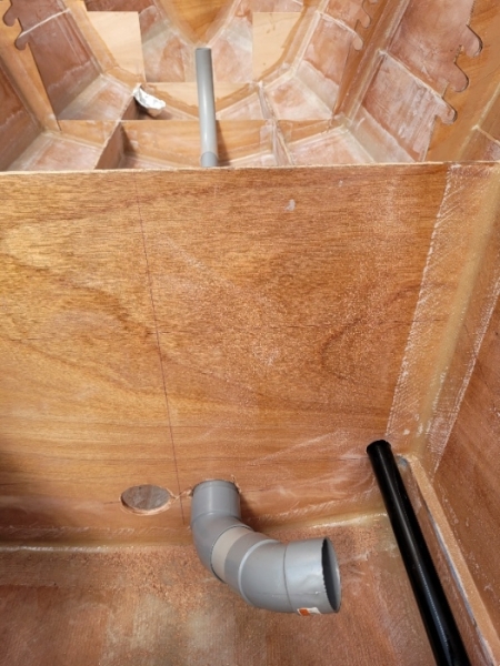

I resumed the project this week. First taped all frames and bulkheads, quite a lot of work, I glassed the anchor well for extra protection, and finally I started working on the cockpit drains and chase tubes. Took some thinking before drilling 40mm holes in the transom and 80mm is the frames...
I'll install 2 master 80mm chase tubes to port and starboard, with small flexible inner tubes as required. Only dry-fitted at this stage, I'll finish next week. All electrical systems to port, fuel and controls to starboard. The battery will be in the aft port locker.
I'm using a 40mm fiberglass-epoxy tube for the cockpit drains. It will be cut to fit.

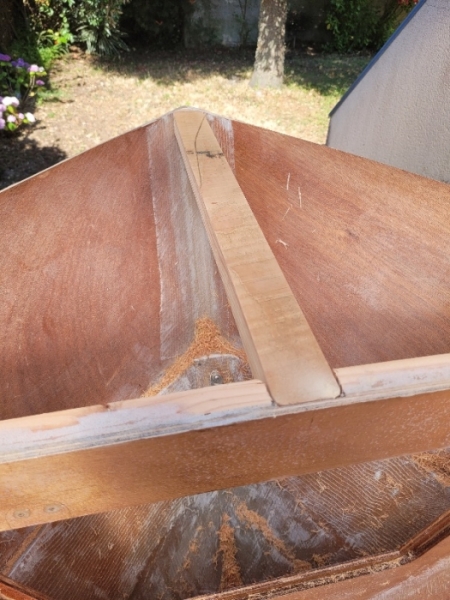

Most of the cockpit cleats are installed. Quite a task, and I only have 2 stringers!
I've built a front desk support out of 25x50mm oak, should be plenty strong.
The cockpit drains were cut flush to the transom and the cockpit bulkhead, and epoxy glued. I have added a third central drain going straight to the bilge, so I'll have the option of draining to the transom or to the bilge.

Testing the cockpit drains. As expected, they're almost flush with the sole, 2-3mm recessed, so they should trap all water in the cockpit. I'm happy with fiberglass-epoxy tubes, they can be glued exactly where desired without overhang.
