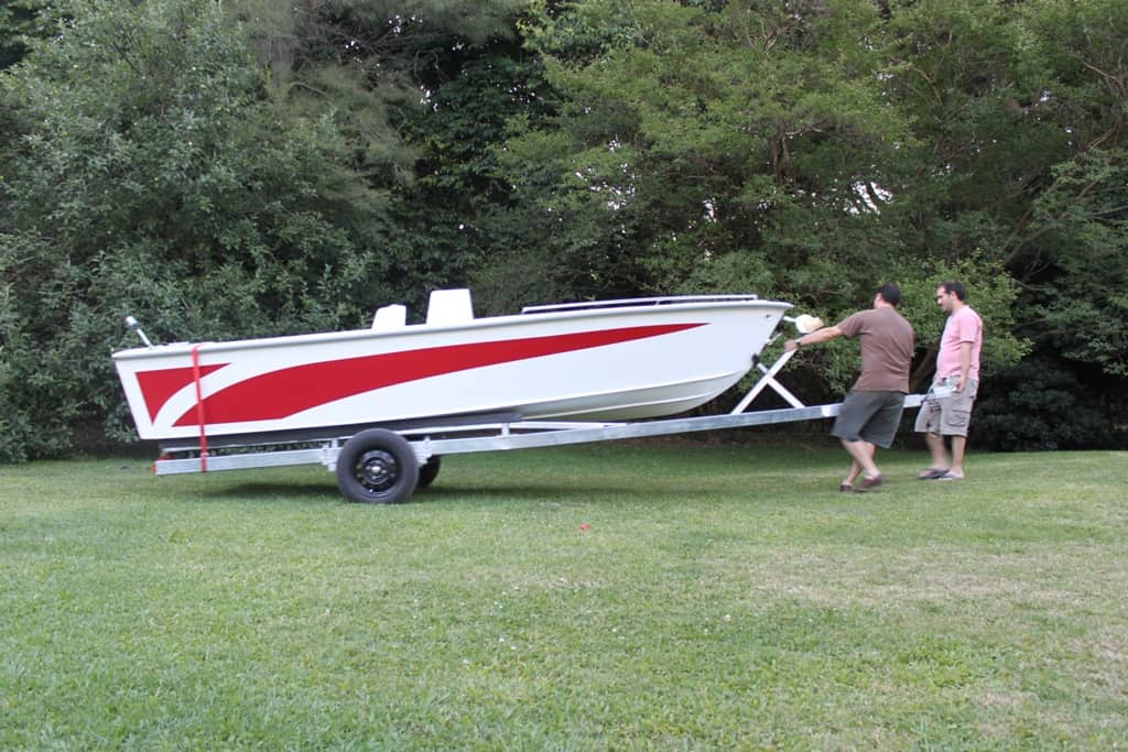

I agree, for water skiing a 17' boat would be better than a 13'. The OB17 would be another good candidate:
Hank

pee wee wrote: Thu May 18, 2023 10:52 am I agree, for water skiing a 17' boat would be better than a 13'. The OB17 would be another good candidate:
Beautiful boat! Is it yours?
What do you think of OB15 + 50 HP?
